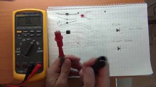

1. Advanced Multimeters - DiodesThis video explains how diodes work and how to use a multimeter to test / trouble shoot them.
Thanks to Comtest South Africa for the loan of the Fluke 87-V – www.comtest.co.za
Other equipment / topics covered in this video:
* Fluke 87-V True RMS digital multimeter
* Zener diodes
* Light emitting diodes / LEDS
* Forward bias
* Reverse bias
* voltage reference
* current shunt / current clamp
* conductance / Siemens -
