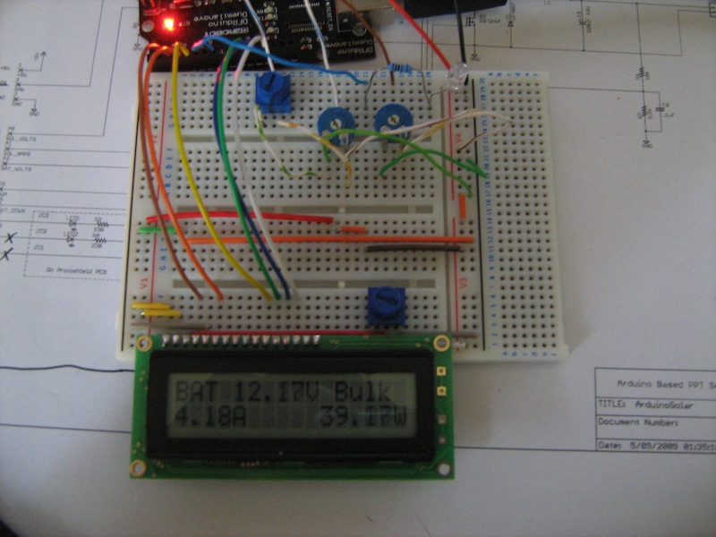

I have got the code going utilising preset resistors to simulate the feedback from a live system to display certain parameters as below.
Now, I ran out of space with a 16x2 LCD. My requirements are to display more information about the charger's status. I have a 20x4 LCD on order, so when it arrives and I figure out the code, I'll post an update.

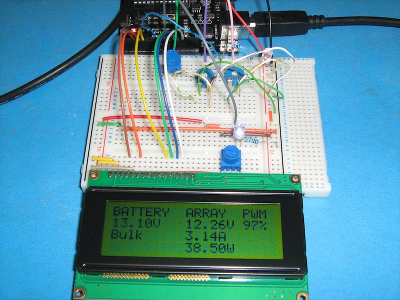

OK, so I have made some more progress with this project.
The 20x4 display arrived and I have got it to display more useful information in a more easy to read manner.
I'm quite pleased with the way it works now.

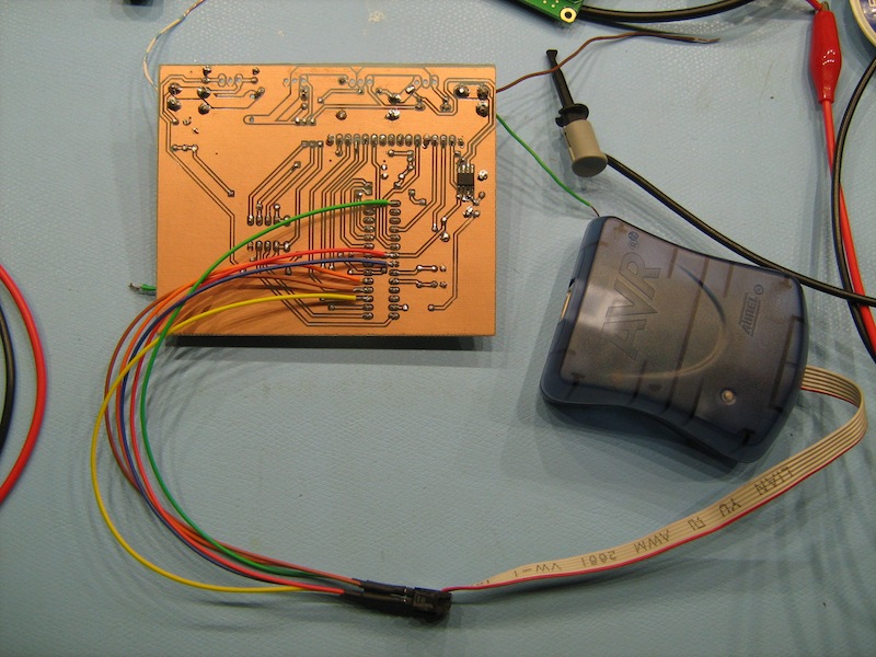

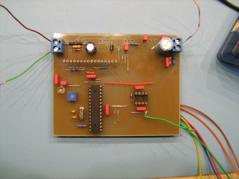

I finished re-designing the PCB and I have fabricated a prototype. Considering that I last made a PCB back in the space year 1996, I am reasonably pleased with the result. I only went single sided because there is less to go wrong. It's not very neat, but it works.
I made a giant error, well two actually, but the first big mistake was that I forgot to include the ICSP header. I have soldered one on temporarily so that the code can be tweaked.
The second big mistake I discovered during testing. The AMPS readout was five times lower than the actual measured current. Like a klutz, I did not read the data sheet for the MAX4173. It turns out that there are three versions of this device. The part number is suffixed with T, F or H. I didn't pay too much attention to this fact when I ordered the chip from Mouser and just clicked on some random one which turned out to be the T version. The T version has a gain of 20, the F has a gain of 50 and the H has a gain of 100.
The design uses a H version with a gain of 100 and my project has ended up with a gain of 20, hence the reason why the readout was 5 times less.
With my bodged on ICSP lead I tweaked the code to get the readings correct.
I have not installed any of the power devices yet until I'm sure that the code is running properly.
Bottom side of the board with the ICSP lead soldered on temporarily.
Top
Top, including the display.
Lessons learned: READ the data sheet! Don't forget to include facilities to alter the code, the code WILL need to be perfected or modified.

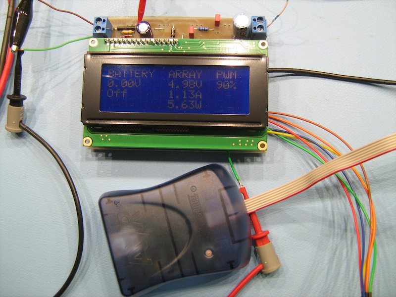

The IR2104 arrived from America this morning, Mouser are really quick.
I have installed it and everything is running well.
In also got the MAX4137H. It is necessary to have this higher gain version because the lower voltage presented to the ADC is too low with the low gain version. This means that the resolution of the measurements is not very good. It not only provides low resolution readings on the display, but the calculations are made with poor quality data.
I'll replace the MAX4173 at the weekend perhaps.
The display updates too quickly to be able to make legible readings. I'll have to figure out how to send updates to the display less frequently.
Otherwise, I'm pleased that it's working.
The sub-assembly with heat sink. For the eagle eyed, the TI part is still on the board at this time.
The fully assembled device.
The unit in operation, charging an actual battery.
After that, I'll start work on getting network or logging or even better, both working for "version 2".

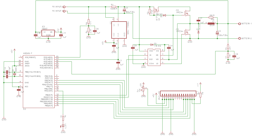

can u share or give the schematics of the MPPT w/LCD using MEGA328?

« Reply #12 on: November 05, 2012, 01:39:53 PM »
« Last Edit: December 12, 2014, 08:13:51 AM by kibi »
