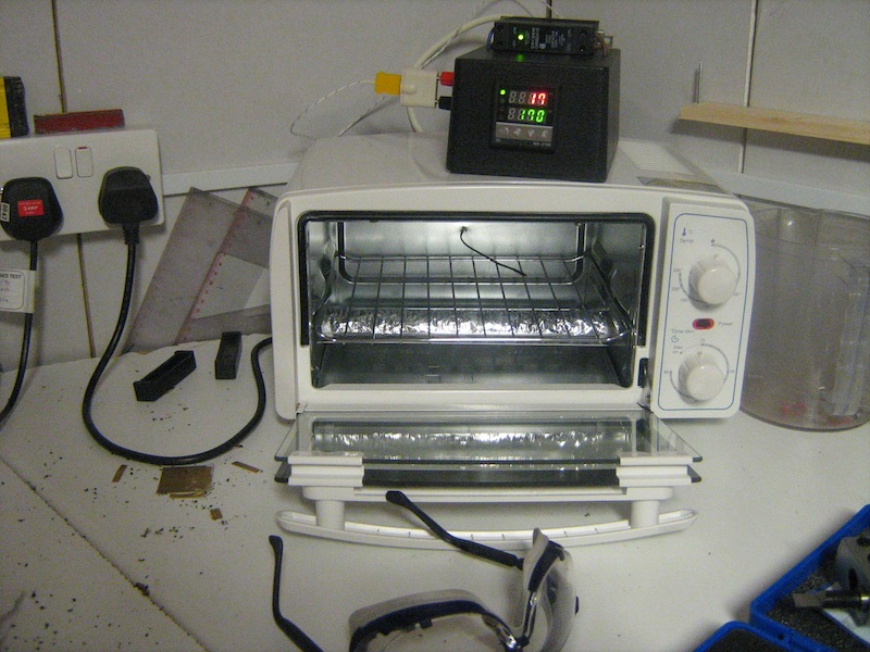

So, I cobbled a reflow oven together. I found a brand new, although crappy, toaster oven in Argos for £12.99, it was the last one too! It's really small too, but perfect for most jobs. Then I got a PID controller for £11.99 and a Crydom SSR off of eBay for £3 (it was £9 for three of them). I already had a thermocouple Sorted, a reflow oven for less than £28!! Bonus.
So I have got the PCB's assembled.

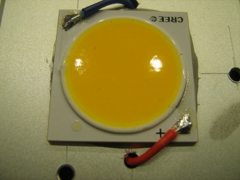

I finally decided that I'd go down the Arctic Silver thermal glue route. The cases are drilled, tapped and the LED's glued down.
With any luck, I'll get on to the final assembly and installation later this week.

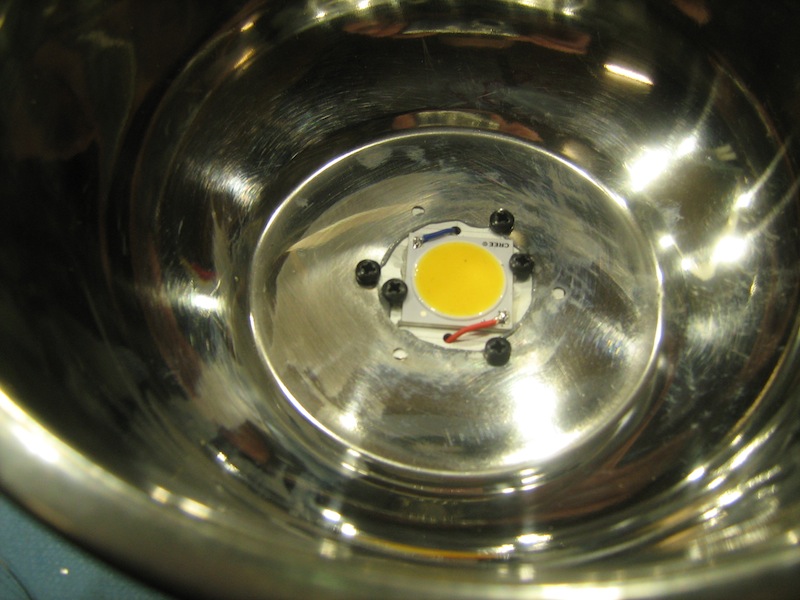

More progress, however I did get the hole circle diameter wrong for the three dog bowl mounting holes. The diameter was 2mm over size, I don't know how I managed that, but I drilled another three 60º "out of phase" and slotted them. No big deal really, but a silly mistake to make.
Things were starting to look good.
Until.......

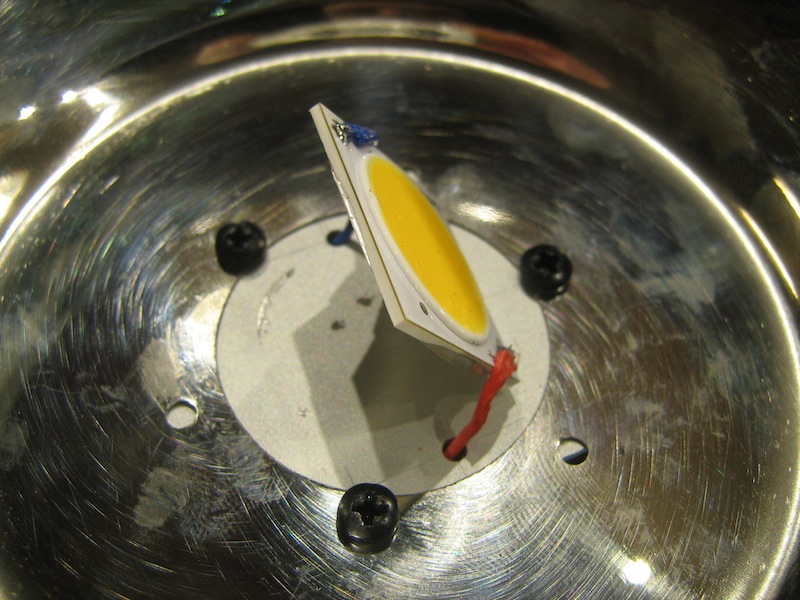

Now, this happened when pressure was applied to the screws whilst screwing the dog bowl to the case. The case obviously flexed and the ceramic substrate of the LED did not. The glue stuck fast even after running them for an hour prior to screwing the dog bowl in position.
I scraped the glue off the LED and tried again, this time rubbing the area with 800 grit paper, still same problem. I also did not like the thermal performance of the glue, it wasn't bad, but not good enough. It'd probably be fine with a bigger heatsink and the glue would definitely stay stuck down when applied to a rigid base.
I did come up with a ghetto solution which is working, so I may well leave it like it is.

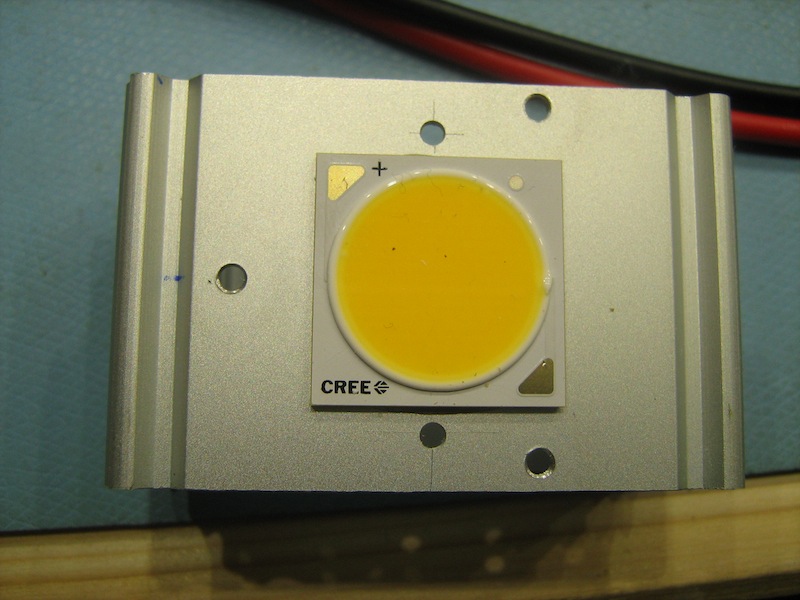

The thermal performance tests failed today. The case temperature went up to 85ºC after just 30 minutes. The die temperature was 105ºC. No good.
A re-design was needed. I was trying to avoid using bigger heatsinks as they increase the protrusion of the lamp. Also they are expensive. I do however have some good heatsinks from a previous project. Integrating these into the design meant almost an entire rework of all the mechanical parts. I had to turn the cases over because the surface that I originally had the LED mounted to now has more holes in it than a second hand dart board. Some of the existing holes would interfere with the new design.

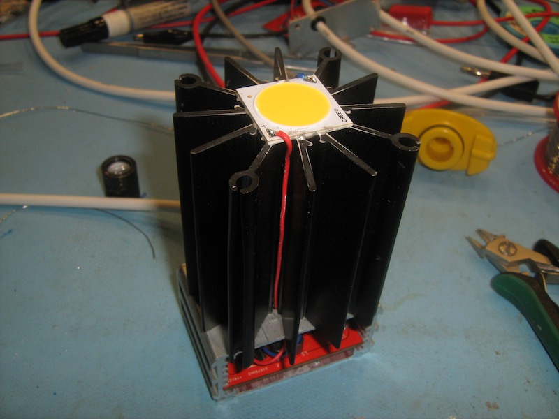

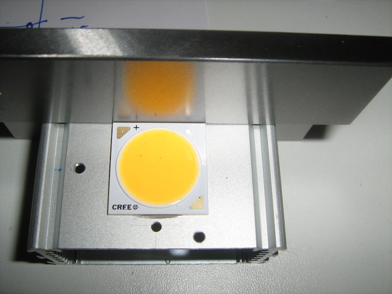

So these are the heatsinks I am now using with the LED, once again, glued on with Arctic Silver epoxy.

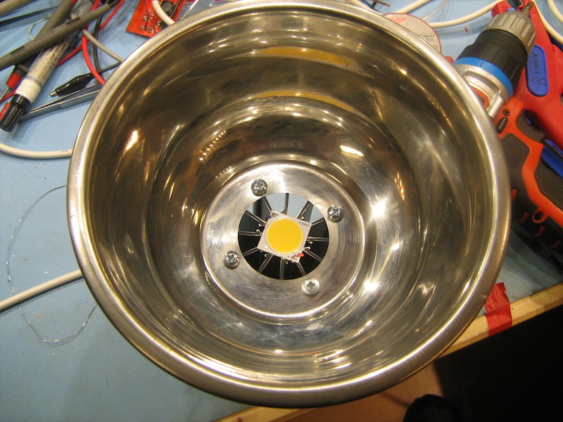

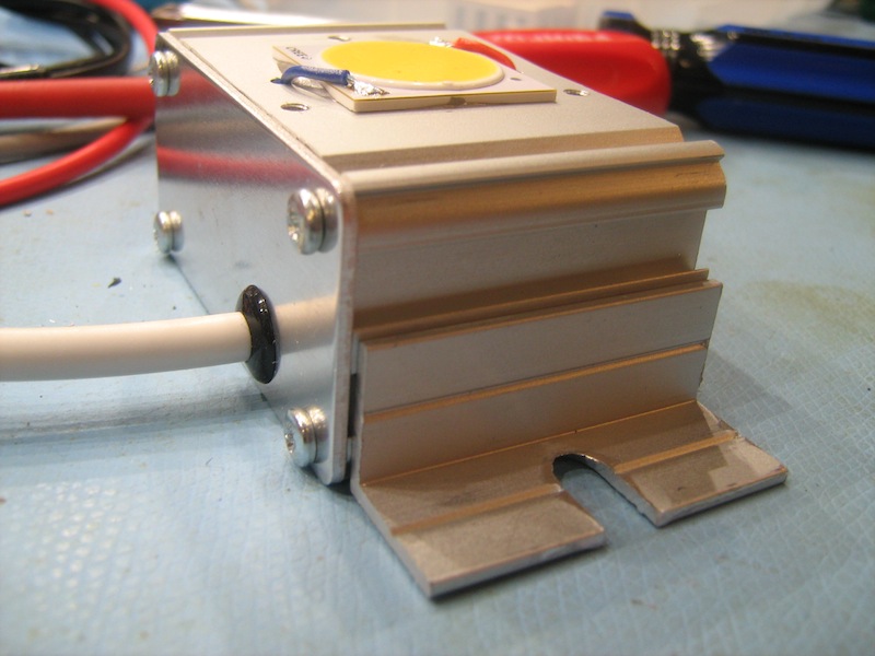

I then enlarged the hole in the centre of the dog bowl to allow for better flow of convection currents. Besides, the mounting holes are now on a much larger diameter.
Now the thermal performance is much improved. I left the lamp on for two hours and the heatsink temperature rose to 50ºC and the die reached about 85ºC. That die temperature is actually what these LED's are binned at so that was a nice coincidence. The glue is performing well now that it is bonded to a better performing heatsink.

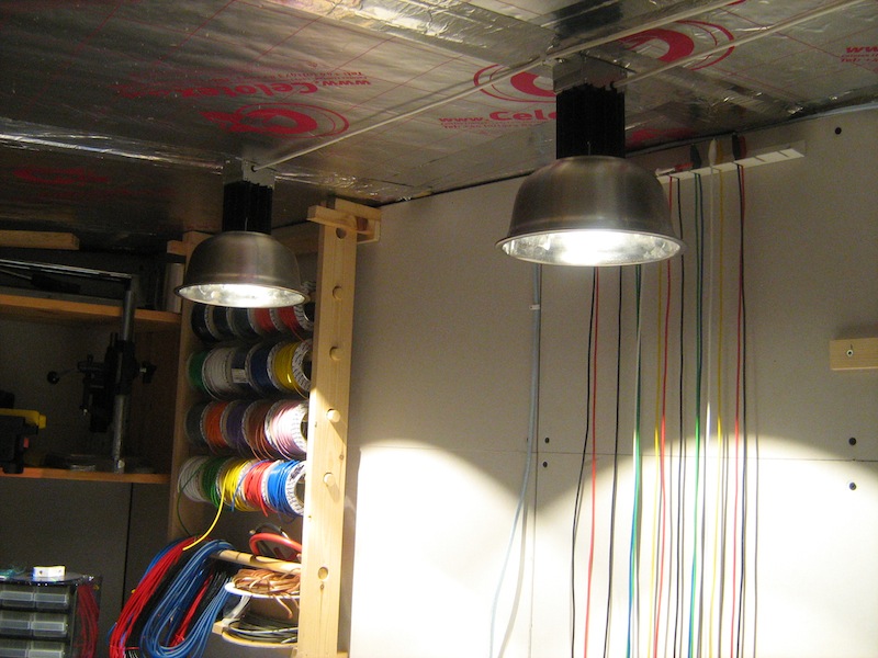

Here are two of the lamps in position. Now I am getting 2500 lux on my worktops for less energy as opposed to the 250 lux I was getting from the fluorescent lamp. Granted, the fluorescent lamp was not in the same position, but directly below the fluorescent lamp at the same height I get 450 lux.
Shadows are a minor problem, about the same as you'd get from a CFL. I plan to reduce the shadows with some diffuser material.

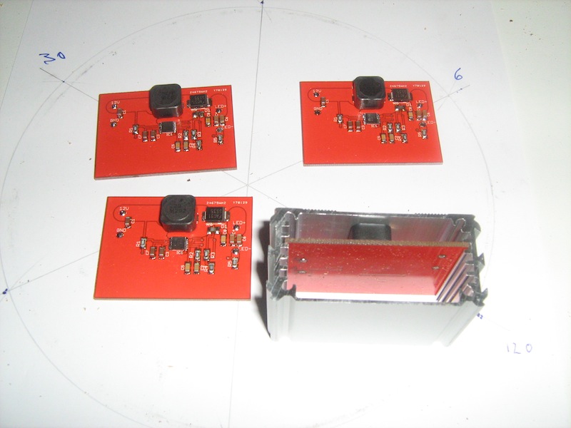

Now, I have used Cree's CXA2011 chips before and they are fantastic, but a bit of a nuisance to drive because they operate at 42V which is quite high. Late last year Cree added some new chips to their CXA range. I went for the CXA2520, which is easier to drive at 36V and produces more light than the CXA2011 modules.
So, it was time to design a driver for the CXA2520. As I am converting my workshop power to off grid, a 12V lamp would be ideal so that I don't have to convert to 240V and then down again to drive the lamp.
Micrel provided the answer for me in the form of their MIC3223. It was cheap, operates from IIRC 5V -20V input, provides programmable constant current up to 1A and can boost up to 37V MAX. Another bonus is that the switch is built in to the MIC3223, so no silly external MOSFETs are required. It switches at 1MHz. It even accommodates PWM dimming control, but you need an external MOSFET for that function of course, but no big deal.
All you need is an inductor, a snubber, diode, a few resistors for programming constant current, high voltage cutoff point and a few capacitors for decoupling.
All of the external components will fit within 1206 packages, so a nice easy, small single sided board layout can be used.
I designed my circuit pretty close to that described in Micrel's datasheet.
I designed the board in Eagle, but I have made it larger that it needs to be because the larger dimension fits nicely inside the case that I intend to use.
I soldered it all on by hand because my PID oven project has ground to s shuddering halt.

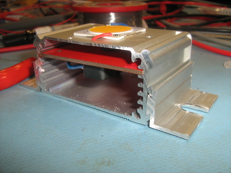

This is the LED on a temporary heatsink for now.
At first the circuit powered up and worked straight away - which was a bit disappointing. However, the fun began when the LED started flashing on and off at 1 or 2 second intervals.
After much debugging, I figured that the bottom pad, which is also pin 17 or EXP on the diagram did not flow. I figured this by the higher than expected temperature of the MIC3223.
I gave the board a quick whirl in my trusty frying pan and then everything worked as it should. The MIC3223's temperature dropped too.

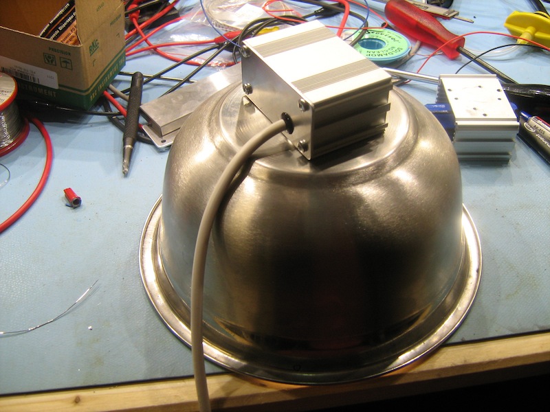

Next thing is to do the mechanical bits. I'll update when it's done.
