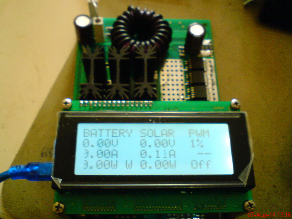

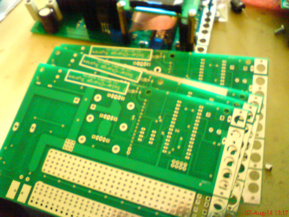

« Reply #57 on: August 07, 2014, 07:06:04 AM »
Hello Folks,
after i made one pcb assembled i try to set it up...
firstly my shunt-resistors (0.025OHM) between mosfet and battery burned...
When the PWM starts, the coil make some strange sounds, about 1Khz and the 5V of the arduino is pulsing.
LCD shows garbage than...
if the solar-volts are smaller as the battery-volts, the system (lcd) shows everything well.
I think there is a need for a seperate 5V, not of the battery.
And there must be an improvement with the mosfet to GND, i dont think this one is needed, it should run also if one takes a diode...
There must be some work on it to do.
At the end my 7805 on the arduino-nano burned too.
So sadly ... but i must stop here!
If anybody is interested in the hardware, i can sell it!
I have another 4 empty pcbs here and the one completely assembled with 4x20 white lcd.
the only thing i need and cant sell is the RF24 Module.
So, who is interested taking over this project?
Regards,
Wolfram.
(Meanwhile i have an Grid-Tie Inverter and have no use for Batteries)
[time... i have not so much time as i would like to have for this project.]
« Last Edit: August 07, 2014, 07:25:03 AM by mega-hz »
