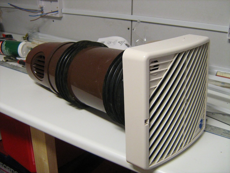

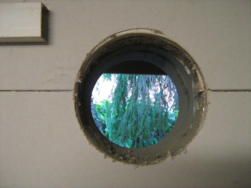

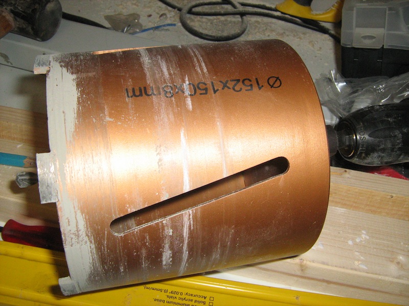

So, today I used this:-
To make this:-
Which is needed to accommodate this:-

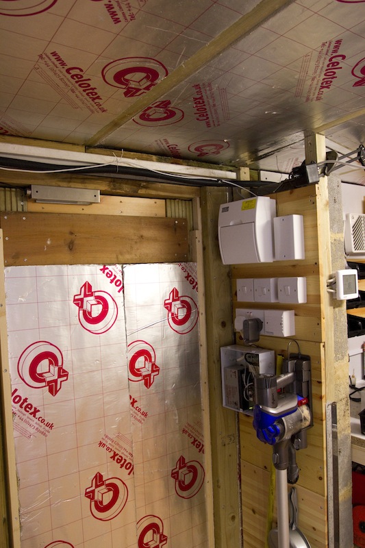

The above is a Vent-Axia heat recovery ventilator. With no windows and the door likely to be shut tight throughout the winter months, ventilation is required. Vent-Axia claim an efficiency of 87% heat recovery on this unit. This is a 24V model with two speeds. High speed kicks in when the built-in humidity sensor detects an excess of 60% humidity. De-humidification is a by-product of it's heat recovery process.

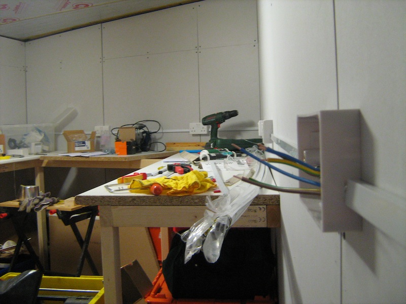

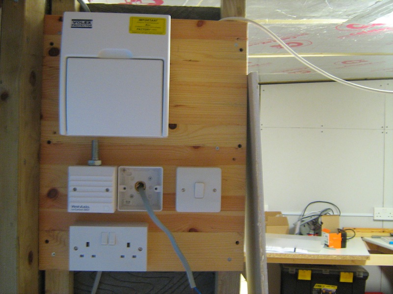

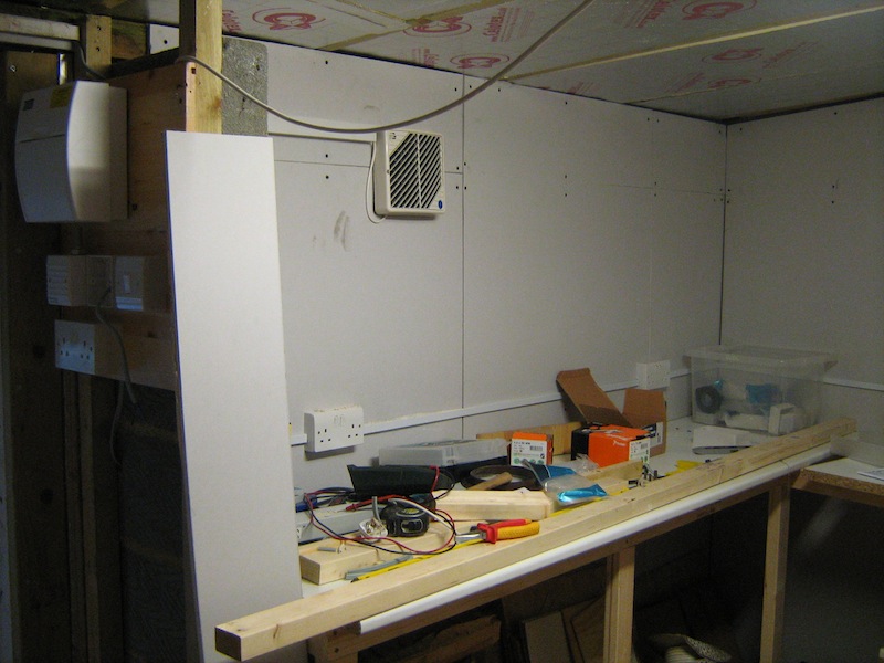

Here I am in the process of wiring up the electrical outlets. There are 11 double outlets around the perimeter of the workshop. You can never have too many outlets and I have never quite figured out the point of single outlets. They are all wired back to the board in a ring main configuration via a 16A, 30mA RCBO. Plenty of power.
The board is looking a lot better now. I have a light switch on the right and on the left is the SMPS for the ventilator.
The worktops are now even more of a mess, but this because I have had to sweep and clean the floor in preparation for the next stage.
Some of you may notice that the ventilator is mounted at a bit of an angle, this is to allow the condensate to run outside of the building for obvious reasons.

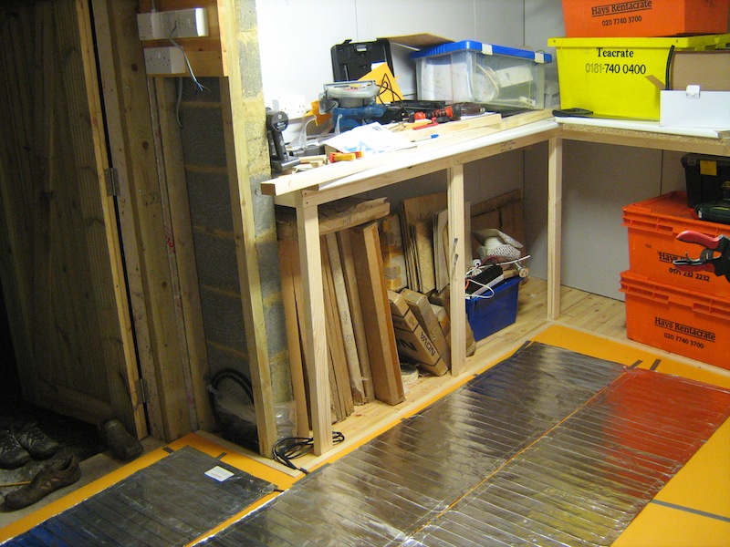

I've put down 6mm sheets of XPS insulation.
Then the underfloor heating mat has been rolled out on top. There is 5 metres of mat with an output of 700W.
That's all for today, hopefully I'll get the flooring down tomorrow.

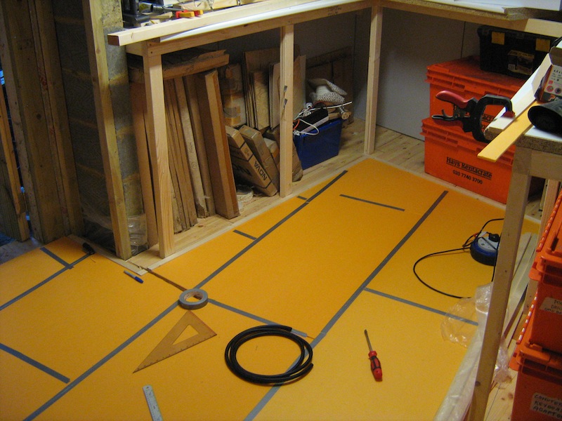

Flooring is down now and the worktops have been completed. Now I just have to sort out some overhead cupboards and then the machines can move in.

Over the last couple of days I have managed to complete the flooring. That was a bit of a nuisance because I finished all the packs of flooring and needed one more board to complete the job.  >:( Luckily my local Wickes had a smashed up pack in stock for £3. :)

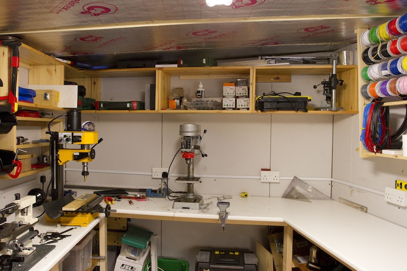

I have then knocked together some shelving from yet more ruined furniture boards. It was lucky that my Bosch blade finally arrived - ebay  ::). I bought a cheap blade in the meantime which managed to do one cut and then on the second cut sparks started flying off of it!!! That blade is now resting nicely in the bin. The Bosch blade made a nice job of the worktops which have also been completed.
Lastly, I have moved my little machines in and bolted them down. They are only babies, nothing like Robrenz' machines, but they get stuff done well enough for me.
I now have to get on with getting the data cabling run down.

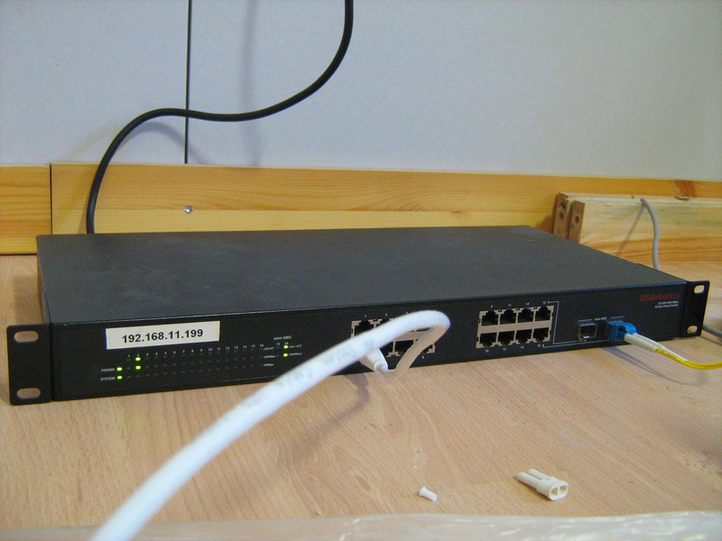

I have got the cabling in today. I have the internet in the workshop!! 8) In fact, I am making this post from the workshop over my new singlemode fibre link :)

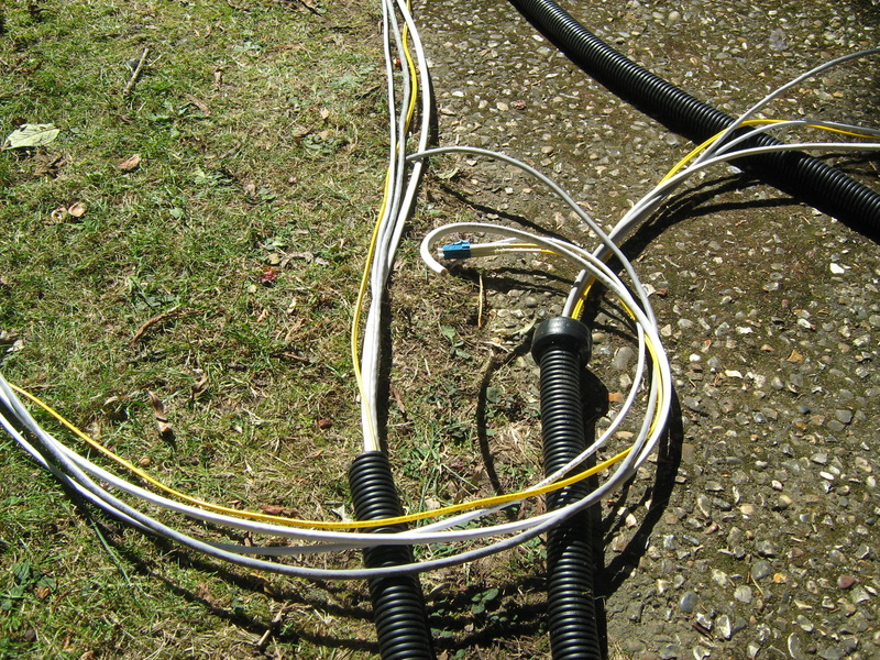

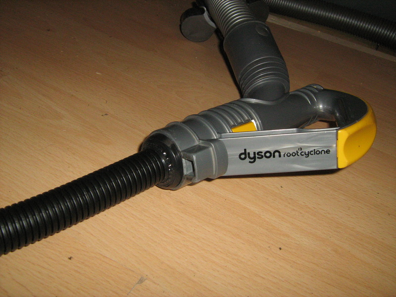

Anyway, enough of that. I used 50 continuous metres of 25mm crush resistant flexible copex. Now because it is one continuous length it posed a challenge to get the cables down it. One would use a cobra, but I didn't have access to one, so I came up with a plan.
Very specialist tools are involved here. ;)

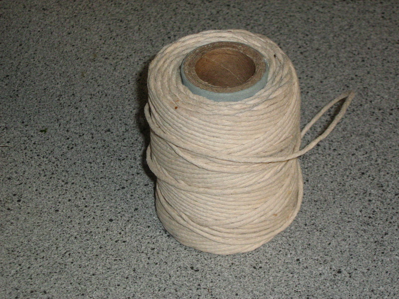

You need one of these:
One of these:
and errr... one of these these:

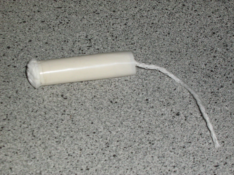

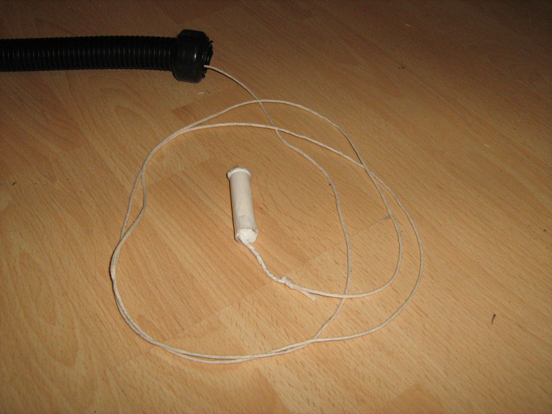

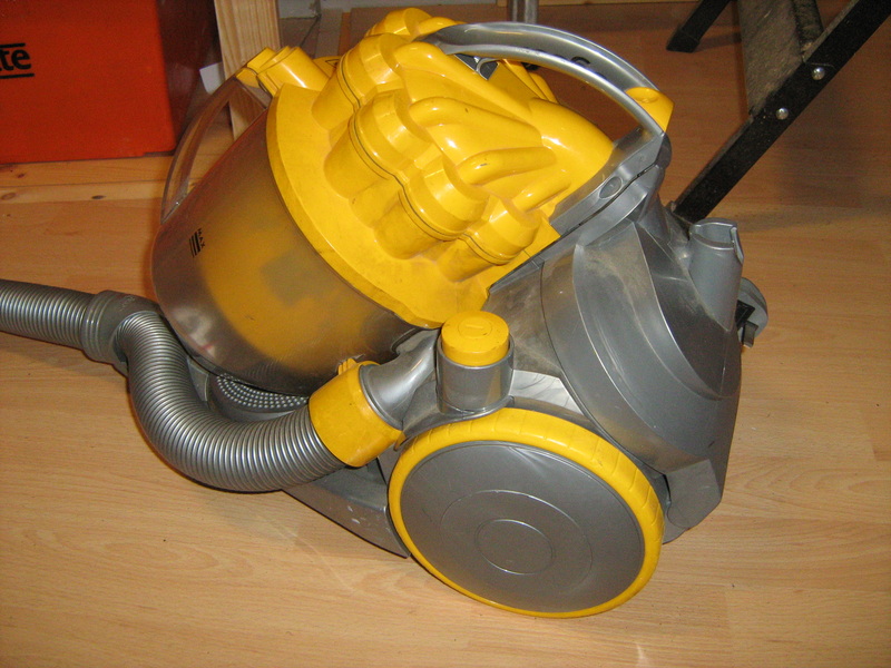

Yes, that is a tampon which I have modified with a bit of tape to maintain it's structural integrity. The tampon will be the mouse. You tie the tampon string to the ball of string. Then you connect the other end of the copex to the vacuum cleaner and switch it on.
The vacuum cleaner end was in my workshop and the open end was lying on my driveway. The copex make a loud screeching sound probably caused by the air rushing past the ridges in it. When I got to my driveway the postman was standing there with a very concerned look on his face :)
I offered the tampon up to the open end of the copex and wham, it shot up the tube faster than Usain Bolt. Unfortunately, contrary to popular belief, when you buy a ball of string, it is not necessarily one complete length. As the string shot down the copex the loose and went hurtling down too with much string remaining on the ball.
No big deal, the tampon and string were waiting for me at the other end and I just tied the loose ends together and it went well on the second attempt.
I pulled one CAT5e cable down first and then with that pulled 1x Singlemode fibre cable, 1x alarm cable and 2x CAT5e cables as spares for whatever happens in the future. I had room for another two CAT5e's, but I only had two boxes of cable on me.
So, there you have it, all up and running.

A tip for next time is that you do not need the tampon. The twine will go through with just the suction from the vacuum alone. I have done this using a pipe, a length of string and an air compressor, using a t piece to feed the air in and the string in the other side, the flow after you have pushed in a metre or so will pull the rest along with it.

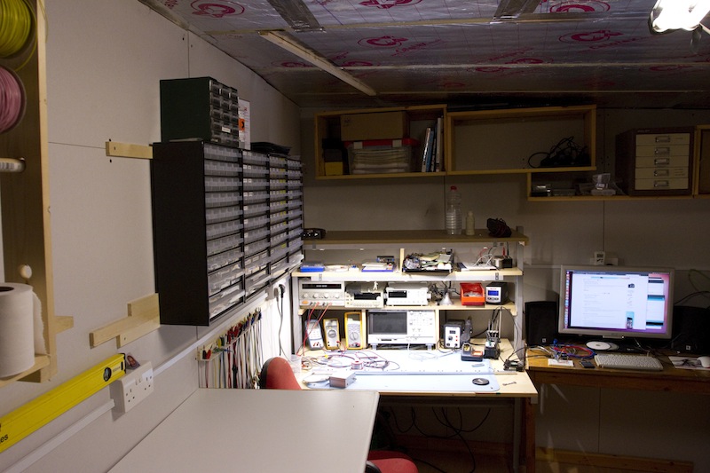

OK, it's been a while since my last update. I've had to get on with other stuff before it gets too cold, like clearing all the rubbish from the project and performing a major service on the car amongst other things.

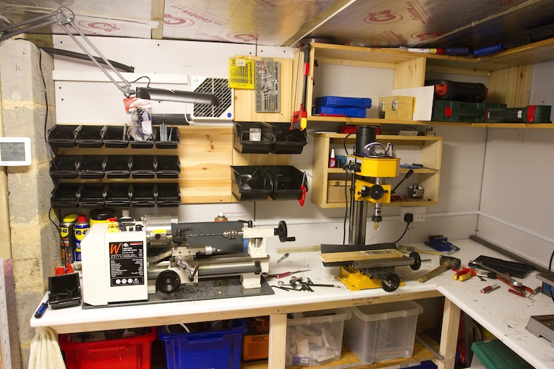

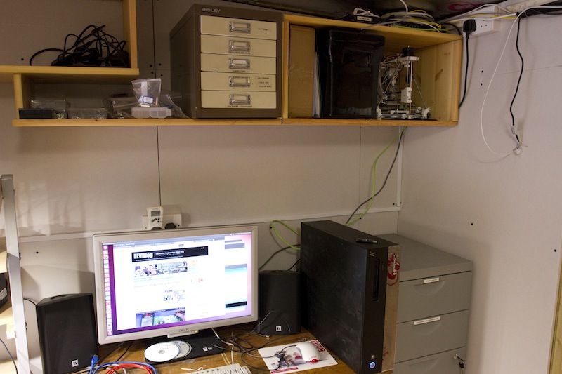

Things have been happening and the inside of the workshop is now pretty much complete. I have put up more shelves (no such thing as too many shelves), cobbled together a computer and done some general sorting. I found a faulty (bad caps) 24" monitor on ebay for £20. I have repaired it and I'm happy with it. I just need some decent speakers, those crappy ones are driving me mad. Mmmm, I detect a new project coming over the horizon. :)
I have insulated the door now, so the heating only needs to be switched on for 20 minutes to get up to 20ºC and then the heat output from the computer (80-100W) will keep it up. In fact it will increase. I'm very pleased with the insulation.
So, I thought I'd upload a little 360º photo gallery.
