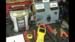

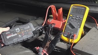

Product "Jump" (Carbon Pile Load) Test Number Claimed Crank and Peak Amps (Amps) Actual Maximum Crank Amps Observed (Amps) Maximum Crank Amps at ~7 Volt (Amps) Initial Voltage (Volts) Stanley J5C09 1000 Peak Amp Jump Starter 1 500 / 1000 400 240 12.7 2 500 / 1000 240 240 12.49 3 500 / 1000 232 229 12.6 4 500 / 1000 195 193 12.5 5 500 / 1000 168 166 12.3 6 500 / 1000 200 185 (5.9 V) 12.3 7 - After Full Charge 500 / 1000 429 429 (5 V) 13.2 NOCO Genius Boost Plus GB40 1000 Amp 1 500 (assumed) / 1000 165 160 12.22 2 500 (assumed) / 1000 220 210 11.7 3 500 (assumed) / 1000 176 174 11.2 4 500 (assumed) / 1000 225 216 11 Anker PowerCore Jump Starter 600 Amp Peak 1 300 / 600 335 335 12.4 2 300 / 600 347 342 12 3 300 / 600 308 308 11.8 Bolt Power G06 Portable 600 AMP Peak 1 300 / 600 290 240 12.22 2 300 / 600 310 290 11.5 3 - Crackle sound from battery 300 / 600 237 237 11.2 4 300 / 600 352 350 11.1 5 - Fail, battery swell 300 / 600 361 361 11 Archeer 800A Peak Portable Car Jump Starter 1 400 (assumed) / 800 240 210 15.78 2 - Some smoke 400 (assumed) / 800 260 240 15.5 3 - Fail - Smoke 400 (assumed) / 800 380 268 14.5 BESTEK 600A Peak Portable Car Jump Starter 1 300 (assumed) / 600 182 170 15.78 2 - Fail - Battery swell and burst 300 (assumed) / 600 241 184 15.5 Product Short Circuit Protection Overload Protection No. of Actual Car Jump Starts Stanley J5C09 1000 Peak Amp Jump Starter Manual Switch No 33 NOCO Genius Boost Plus GB40 1000 Amp Yes Yes 16 Anker PowerCore Jump Starter 600 Amp Peak Yes Yes 11 Bolt Power G06 Portable 600 AMP Peak Yes - Fails Yes - Fails NA Archeer 800A Peak Portable Car Jump Starter Yes Yes - Fails NA BESTEK 600A Peak Portable Car Jump Starter Yes Yes - Fails NA
