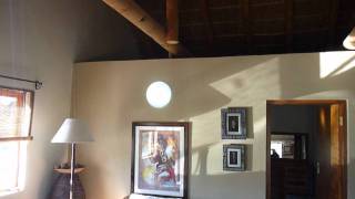

        1. Off Grid Solar Cottage
        In this video I complete an off grid solar installation and install LED lighting for efficiency. The odd ostrich and cheetah make an appearance too!
        African Game Lodge – http://www.africangamelodge.co.za/

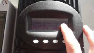

        8. Off Grid setup, PWM vs MPPT
        In this tutorial we take a look at off grid solar power setup, pulse width modulated vs maximum power point tracking charge controllers (Steca PR1010, Morningstar Sunsaver TrackStar MPPT, Outback FlexMax 60)
