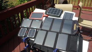

1. Portable USB Solar Panel Charger Review / Tests - Part 1In this video I test 11 portable / folding USB Solar Panel Chargers to see how well they perform.
* SunKingdom 39 Watt
* ChoeTech 19 W Portable Solar Charger – http://astore.amazon.com/m0711-20/det…
* RAVPower 15W Solar Charger (with iSmart) — http://astore.amazon.com/m0711-20/det…
* Smart Tech Apollon P15 15 Watt – http://www.buykorea.org/product-detai…
* Anker® 14W Dual-Port Solar Charger with PowerIQ
* All Power AP® Solar Foldable Charger 7W
* Voltaic Systems 6.0W “Fuse 6W”
* Smart Tech Apollon P5 5 Watt
* SUNKINGDOM™ 5W 5V
* Voltaic Systems 4.0W “Amp”
* Voltaic 2.0 Watt Solar PanelUPDATE: See all the results here

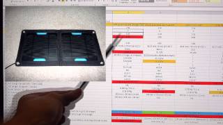

- 1.1 Results – Table 1
- 1.2 Results – Table 2
- 2 Specs
- 3 Actual vs Quoted Power Ratings
- 4 Actual Panel Performance Compared
Our Solar / Sunlight Simulator Test Gear allows us to consistently test panels and equipment in ideal and less than ideal conditions.
1.1 Results Table 1
1.2 Results Table 2
2 Specs
Make and Model Quoted Power Rating Actual Power Rating - Normal Conditions % of Actual vs Quoted Power 1 Hour Energy Rating (Watt Hour) iPhone Charges in 1 hr ALLPOWERS 15W Dual USB Portable Foldable Panel Charger 15.0 W 9.2 W 61.5 Anker PowerPort Solar Lite 15 W 15.0 W 7.2 W 48.1 Anker 14W Dual-Port Solar Charger with PowerIQ 14.0 W 7.4 W 52.6 AP Solar Foldable Charger 7W 7.0 W 3.3 W 47.1 CHOETECH 19W Portable Solar Charger 19.0 W 10.1 W 53.3 Goal Zero Nomad 7 Solar Panel - DC Connection (7 W) 7.0 W 5.0 W 71.4 4.85 1 Goal Zero Nomad 7 Solar Panel - USB Connection (5 W) 5.0 W 3.8 W 76 3.85 0.8 Poweradd 14W Solar Charger Portable USB Solar Panel Charger 14.0 W 7.6 W 54.3 RAVPower 15W Solar Charger with Dual USB Port 15.0 W 9.9 W 66.1 Smart Tech Apollon P5 5.0 W 3.4 W 67.2 Smart Tech Apollon P15 15.0 W 10.4 W 69.3 SUNKINGDOM 5W 5V Portable Ultra-thin Solar Panel Charger 5.0 W 2.5 W 49.8 SUNKINGDOM 39W Mono-crystalline Folding Solar Panel Charger With Dual 18V DC and USB 5V Output 39.0 W 12.9 W 33.2 Vinsic® 15W High Efficiency Solar Panel Foldable and Portable Dual-port Solar Charger 15.0 W 6.6 W 44 Voltaic 2.0 Watt Solar Panel 2.0 W 1.8 W 88 Voltaic Systems 4.0W "Amp" 1018-S Portable Solar Charger and 4000mAh USB Battery 4.0 W 3.0 W 73.8 Voltaic Systems 6.0W "Fuse 6W" 1030-S Portable Solar Tablet and Phone Charger with 4000mAh USB Battery 6.0 W 3.3 W 54.8 AUKEY 20W 2-Port Solar Charger 20.0w 9.8 W 49 4 Actual Panel Performance Compared
Solar Panel Area (cm2) Solar Panel Performance (mW / cm2) ALLPOWERS 15W Dual USB Portable Foldable Panel Charger 916.5 10.06 Anker PowerPort Solar Lite 15 W 650 11.09 Anker 14W Dual-Port Solar Charger with PowerIQ 1098.24 6.7 AP Solar Foldable Charger 7W 454.4 7.26 CHOETECH 19W Portable Solar Charger 888.75 11.39 Goal Zero Nomad 7 Solar Panel - DC Connection (7 W) 533 9.38 Goal Zero Nomad 7 Solar Panel - USB Connection (5 W) 533 7.13 Poweradd 14W Solar Charger Portable USB Solar Panel Charger 715 10.63 RAVPower 15W Solar Charger with Dual USB Port 1163.25 8.53 Smart Tech Apollon P5 288.96 11.63 Smart Tech Apollon P15 844.8 12.31 SUNKINGDOM 5W 5V Portable Ultra-thin Solar Panel Charger 258 9.65 SUNKINGDOM 39W Mono-crystalline Folding Solar Panel Charger With Dual 18V DC and USB 5V Output 2175.12 5.94 Vinsic® 15W High Efficiency Solar Panel Foldable and Portable Dual-port Solar Charger 637.5 10.35 Voltaic 2.0 Watt Solar Panel 151.2 11.64 Voltaic Systems 4.0W "Amp" 1018-S Portable Solar Charger and 4000mAh USB Battery 302.4 9.76 Voltaic Systems 6.0W "Fuse 6W" 1030-S Portable Solar Tablet and Phone Charger with 4000mAh USB Battery 385 8.55 AUKEY 20W 2-Port Solar Charger 1014 9.66
